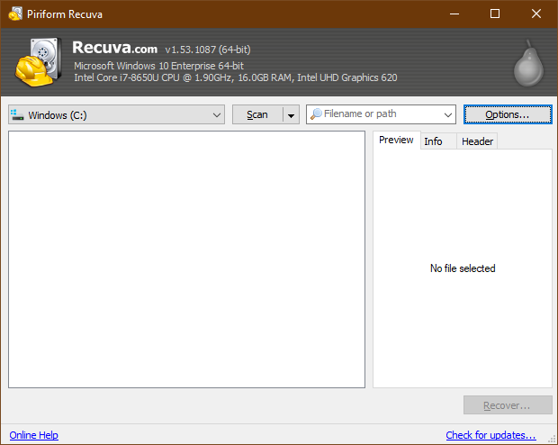

  1. Start Recuva. If the Wizard launches, enter Advanced mode by clicking Cancel.
  2. Click Options.

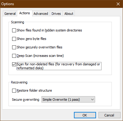

  3. In the Options dialog box, click the Actions tab.
  4. Click Scan for non-deleted files, and then click OK.
